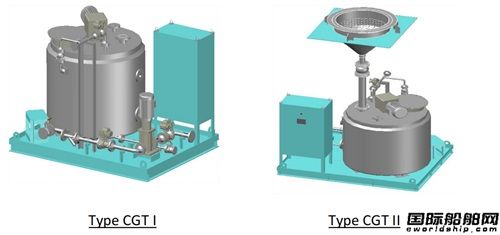

针对上述问题,通过采纳结合各方的安装和操作建议,汇舸环保自主研发设计了 CGT 系列尿素液制造装置。
用船舶造水机生产的纯水按配比加入定量的尿素颗粒后,在搅拌罐内充分搅拌,同时对搅拌罐夹套内的加热用淡水进行加热,加快和确保尿素颗粒彻底溶解。
同时罐体增加排气口,按需引管到敞开甲板,使得尿素液制造场所的环境可视为零污染,确保了尿素液 AUS4O 生产的安全性和高质量。

In view of the above problems, ContiOcean independently developed and designed the CGT series urea solution production plant, by adopting the installation and operation suggestions of various parties. Quantitative urea granules are added to the pure water produced by the ship's water generator according to the ratio, and are fully stirred in the mixing tank, while jacketed heating is used to speed up and ensure the complete dissolution of urea granules.
At the same time, an exhaust port is added to the tank, and the pipe is led to the open deck as needed, so that the environment of the urea solution production plant site can be regarded as zero pollution. Ensure the safety and high quality of AUS4O production of urea solution. At present, urea solution production plant of various specifications and models have been highly recognized in domestic and overseas markets, especially in Japan and South Korea, and have achieved good sales performance.
